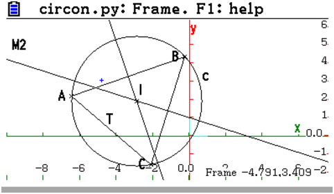

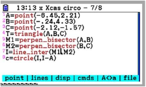

Example : circumcircle.
From KhiCAS shell, type F6 1 then select new figure 2d EXE. Type F4 5 Triangle, EXE to create the first vertex, move the pointer with cursor keys and type EXE for the second vertex, move the pointer again and type EXE to create the 3rd vertex and the triangle.
Long version, construction of the center: Type F4 7, select 8 Perpen bisector, move the pointer so that only one edge of the triangle is selected (this is displayed at the bottom right, something like perpen_bisector D5,D, type EXE will create the perpendicular bisector. Move the pointer to another edge of the triangle, type EXE to create the 2nd bisector. You may optionnaly create the 3rd bisector. Then type F4 6, select 4 Single intersection. Move the pointer to a perpen bisector, type EXE, move the pointer to another perpen bisector and type EXE. This will create the circumcircle center. Type F4 4, move the pointer to the center (with the cursor keys or by typing ALPHA H or the center name if it is not H), then EXE, move to one of the triangle vertex and press EXE.
Short version with the circumcircle command: Type F4 9, select circumcircle, select each vertex with pointer move + EXE ((ALPHA A EXE ALPHA B EXE ALPHA C EXE, replace A, B, C with the vertices names).
Symbolic view version: If you are in the graphical view, type EXIT to move to the symbolic view. Move to the script end and add a newline if required (shift EXE). Enter
c:=circumcircle(A,B,C) EXE

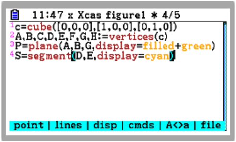

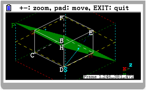

3d Example
c:=cube([0,0,0],[1,0,0],[0,1,0]);
A,B,C,D,E,F,G,H:=vertices(c);
P:=plane(A,B,G,display=filled+green);
S:=segment(D,E,display=cyan);
onload
Type F6 1 from the shell, then select new 3d figure. Then EXIT or EXE to switch to the symbolic view. Then F5 c ALPHA shift = F4 uparrow twice, select 3D, EXE 5 for cube, F6 for help on the cube command, press F2 to copy+paste the first example in the symbolic view. You should see
c=cube([0,0,0],[1,0,0],[0,1,0])
Type EXE, this display a small cube, type + a few times to zoom in. Then EXE to switch back to symbolic view. Type shift EXE to begin a new commandline. Now we define the vertices of the cube with A,B,C,D,E,F,G,H= (type ALPHA A , ALPHA B etc.). Then type F4 and uparrow 3 times to select Geometry then uparrow 4 times to select sommets EXE, put c as argument to get sommets(c). Type EXE to display the cube and the vertices with their names. Type EXE again to go back to symbolic view. Then shift EXE to enter a new commandline, that will define the plane ABC. Type ALPHA P = then F2 to open the fast menu lines and 8, this will copy plane(. This command takes 3 points as argument (or a cartesian equation), here A, B, G, P=plan(A,B,G,. We now add a color to the plane with the F3 disp fast menu display=filled+green. Check by EXE EXE. Go to the next line (shift EXE) and create segment DE ALPHA S = F2 select segment command with EXE, type D, E, then F3 and give a color
S=segment(D,E,color=cyan) The whole construction should be
A,B,C,D,E,F,G,H=vertices(c)
P=plane(A,B,G,display=filled+green)
S=segment(D,E,display=cyan)
Type EXE to display it and use the keypad to change the viewpoint.

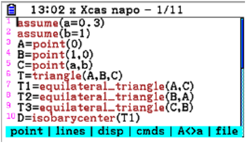

Let’s show another theorem with the same setting, Napoleon’s theorem. Construct three equilateral triangles on each edge of the triangle. Then the centers of these equilateral triangles are themselve an equilateral triangle. On peut faire de même pour les médiatrices. Pour les bissectrices,
T1:=equilateral_triangle(A,C)
T2:=equilateral_triangle(B,A)
T3:=equilateral_triangle(C,B)
D:=isobarycenter(T1)
E:=isobarycenter(T2)
F:=isobarycenter(T3)
triangle(D,E,F,display=red)

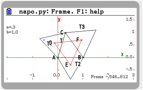

Now let’s prove the theorem, run the following commands in the shell
simplify(distance2(D,E))
simplify(distance2(E,F))
simplify(distance2(F,D))
or with a single command
simplify(distance2(D,E)-distance2(E,F))
