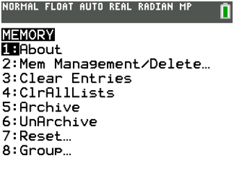

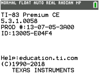

Before beginning,
check which OS version is installed on your calc with 2nd mem 1,
on the following screen capture it is 5.3.1
Download the very same OS version from tiplanet, in case there is a problem during install and you would have to reflash the calculator OS after 2nd-del-reset cancel. - Now get KhiCAS either from the web server of Institut Fourier CAS for TI84+CE or from this site (gitbub).
- The current install process requires that you purge the
archive memory of your calculator, including language packages.
Therefore backup your data and applications and lang packs with
TI Connect CE.

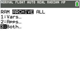

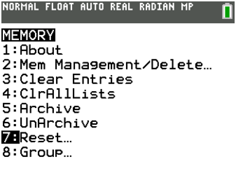

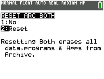

Then2nd mem 7rightarrow 3 2
- Type
2nd mem 1and check archive free (ARC FREE line 2), it should be 2948K or 3014K. If not, you must removing language packs, type1, scroll to the language packs, typedeland confirm with2. - Send INST, artific2 and
