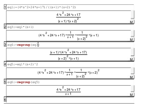

Is there a way to get (s+1) to cancel in lines 2 and 3 the way (s+1)^2 cancels in lines 4 and 5?

You must use something more powerful like normal or factor, regroup does not check for inverses.

Sorry to press but, why does line 5 work?

XcasEngGuy a écrit :Sorry to press but, why does line 5 work?
Because the two inverses are following.
