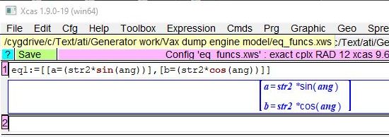

It appears that xcas is no longer putting in the parenthesis around the argument in sin:
The xcas entry:
produces:
\(\left[\begin{array}{c}a=\mathrm{str2}\cdot \sin \mathrm{ang}\\b=\mathrm{str2}\cdot \cos \mathrm{ang}\end{array}\right]

\noindent \framebox{1} {\tt eq1:=[[a=(str2*sin(ang))],] } \\
\begin{equation} \label{eq:0}
\end{equation}
\noindent \framebox{2} {\tt } \\
\end{document}

par parisse
It seems it is a question for Luka.
Note that you can run
Code : Tout sélectionner
latex("legacy",1)
in your session before converting to latex, this should switch to my old latex code with parenthesis around the argument.

par lukamar
New latex conversion omits parentheses when applying functions to simple arguments like e.g. x. I will add an additional condition that the argument must be a one-letter symbol, which should make the output better (one-letter symbols are typeset in italic, so removing parentheses wouldn't affect readability).
