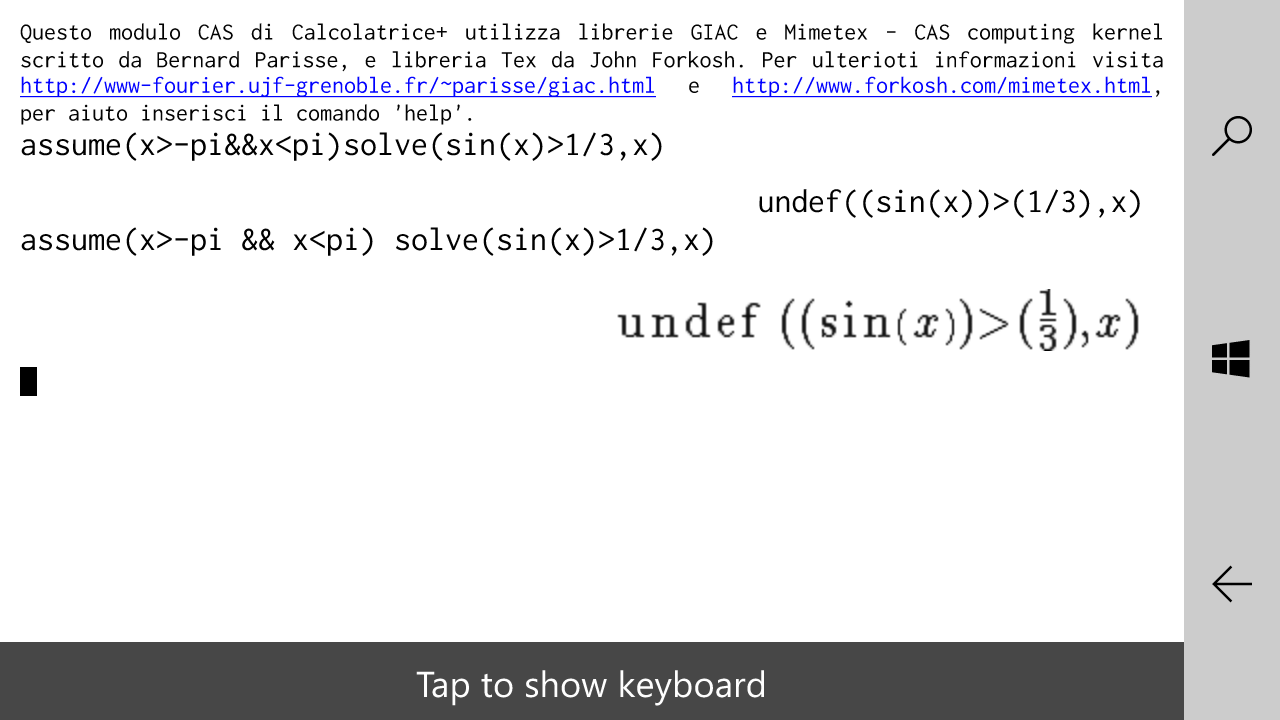

Thank you very much, i also tried now with Khicas and this syntax but output:
Undef((sin(x))>1\3,x)
Also on the app of Xcas that i have on my Phone output the same, but i don't
Know if this app use Khicas or not...

parisse
Messages : 5959
Inscription : mar. déc. 20, 2005 4:02 pm
Contact :
Re: use of Khicas and Xcas
Message par parisse » sam. nov. 25, 2017 7:27 pm

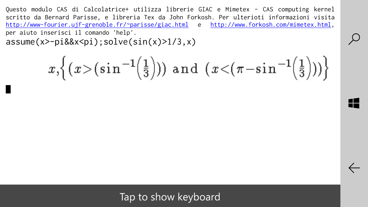

That's normal, you must enter the 2 commands in 2 separate commandlines or add a semicolumn (;) between them.
Federico Di Ceglie
Messages : 17
Inscription : sam. nov. 25, 2017 9:35 am
Message par Federico Di Ceglie » sam. nov. 25, 2017 8:06 pm
parisse a écrit :That's normal, you must enter the 2 commands in 2 separate commandlines or add a semicolumn (;) between them.
Infact now it works on my app, on Khicas output an error with the argument (bad argument).
