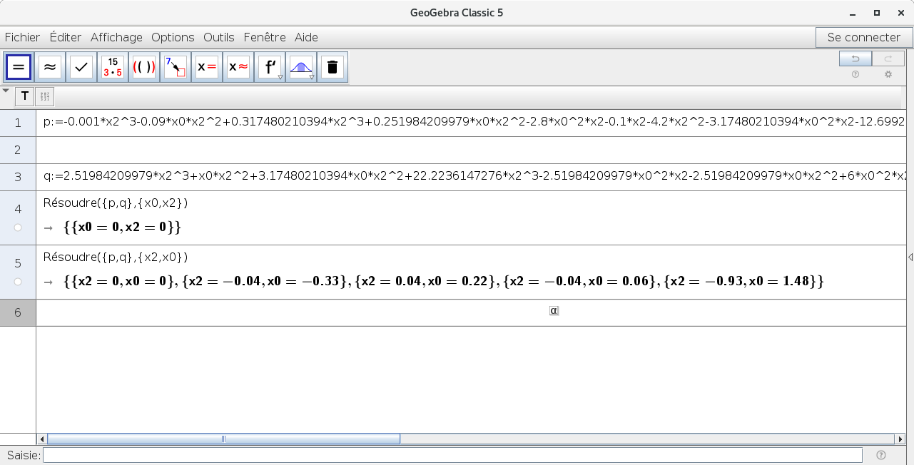

Yes but I think it is just because the windows dll is built with less dependency (may be lapack here?) so here is could encounter some accuract problem with [x0,x2] and not with [x2,x0]
Indeed it does the same in geogebra:
Capture du 2019-01-14 07-32-56.png (43.41 Kio) Consulté 20592 fois
