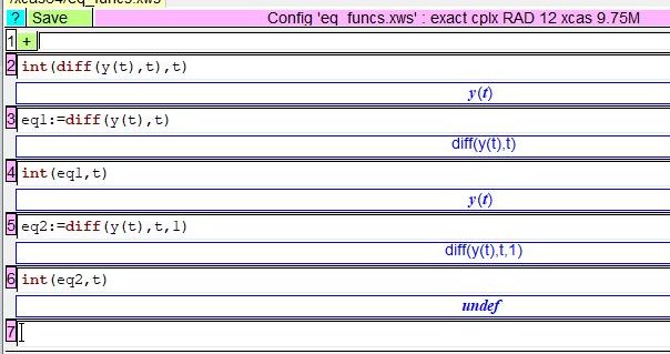

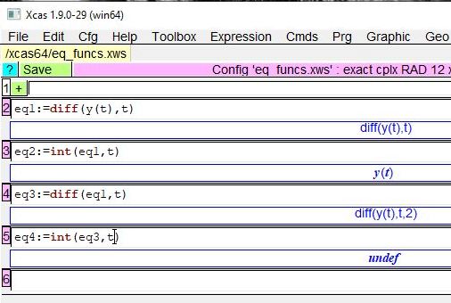

I am trying to work with differential equations and found this:
It appears the integrate function can only integrate dy/dt back to y but not d2 y/dy2 back to dy/dt.

Also, it doesn't integrate dy/dt back to y if it is entered as
diff(y(t),t).
If you enter
eq1 := diff(y(t),t,1)
then again
int(eq1,t)
returns undef.
Oddly, perhaps,
diff(y(t),t,1)
returns
diff(y(t),t,1)
I expected
diff(y(t),t)

It appears that any diff command with 3 arguments won't integrate back. int(diff(y(t),t),t) seems to work for me.

Well, Xcas is not really implemented for solving these kinds of integrals, it expects defined symbolic argument. I'm able to fix these simple examples, but integration by part for example will not work.
