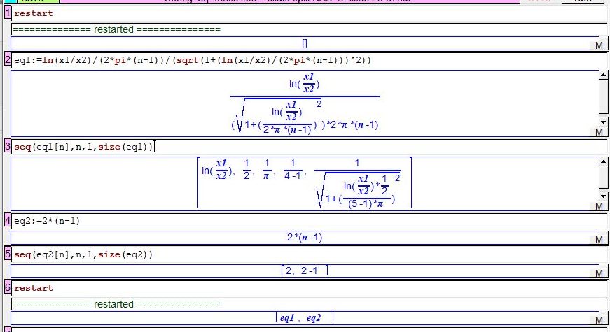

I occasionally use seq to extract terms from equations so I can manipulate them individually. I noticed that it substitutes a value into my equation if a variable in my equation matches a variable in the seq command.
Is this a bug? I have not been able to check other commands for similar behavior. I am worried as I use the programming in xcas extensively and this occurs with local variables also.

You can run op(eq) to extract all the arguments of the root-operator of eq in a sequence (or [op(eq)] in a list).

That's what I needed.
