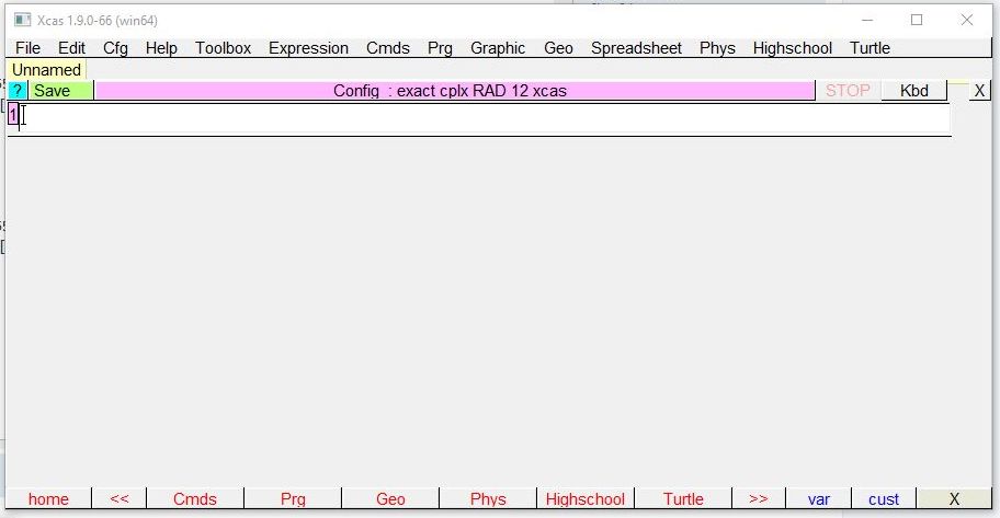

When I start xcas with a file on the commandline:
$XCAS_ROOT/xcas.exe "$(pwd)/eq_funcs.xws" "$@"
from a modified runxcas.en the Bandeau and other items at the bottom are not there. Any filename on the command line seems to cause this behavior. Turning them on and saving the config does not make them come up the next time I start xcas. This used to work, but I can't remember how many versions back that was. The stock works fine, the items appear as they should, however they were when I saved configuration in the cfg menu.
By the way, is the configuration saved in the xws file? That might cause it.
Thanks
Matt

The global configuration is saved in ~/.xcasrc on Unix systems (and therefore always esay to find), and in the start directory in xcas.rc in Windows. The issue is most probably that xcas.rc was not found in your situation, perhaps because the start directory was not c:\xcaswin or c:\xcas64.

I'm using Windows 10 and it seems that it is more than that. If you drag and drop a xws file to one of the original batch files that run xcas, the same thing happens.

If the env variable XCAS_ROOT is set, then xcas.rc should be read from this directory. If not, then you can run xcas from a shell with I/O (like the bash shell inside xcas directory) and see some informations displayed about xcas.rc.

Thank you. This does load the config file. After experimenting with it, this problem acts like the bandeau configuration is not stored in the xcas.rc file. Can you tell me where the bandeau configuration is stored so I can research this further? If I know where in the xcas.rc file the visibility of the bandeau is stored I can tell if it is getting reset.

The bandeau/scientific keyboard configuration is encoded in xcas.rc after the fontsize and geometry of the window by bits 0 and 1 of an integer, e.g. 1 here:
widget_size(18,40,90,900,550,1
0 or 1 means scientific keyboard OFF/ON
0 or 2 means Bandeau OFF/ON

Here is the contents of xcas.rc on my machine.
widget_size([0,17,40,10],1275,90,903,927,2,0,0,[88,255,60,255,216,255,56,255,56,255,49],"'/cygdrive/c/Program Files (x86)/Google/Chrome/Application/chrome.exe'",0,0,"","","A4",60);
cas_setup(0,0,1,1,0,[1e-12,1e-15],12,[4,100,0,25],0,1,0,1),xcas_mode(0);
xyztrange([-10.0,10.0,-10.0,10.0,-10.0,10.0,-10.0,10.0,-10.0,10.0,-1.4,1.1,1,0.0,1.0,3]);
autosimplify('Nop')
I believe that the 2 after 927 in widget_size is the integer you specified. xcas honors that value as long as no xcas file is included on the command line. Here are my startup files:
