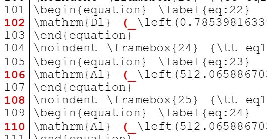

Thanks. I think the most troublesome error is caused by the underscore after the = sign, before \left (see attached image)

Re: Latex output bugs?
Yes, that should be fixed. And \_ will be infixed.
