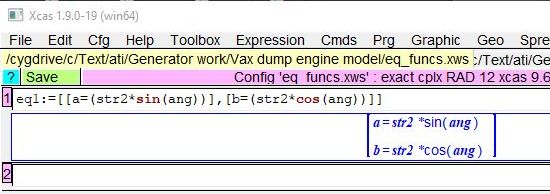

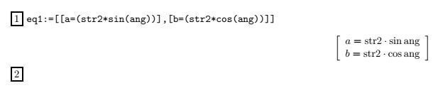

It appears that xcas is no longer putting in the parenthesis around the argument in sin:
The xcas entry: produces: \(\left[\begin{array}{c}a=\mathrm{str2}\cdot \sin \mathrm{ang}\\b=\mathrm{str2}\cdot \cos \mathrm{ang}\end{array}\right]

It seems it is a question for Luka.
Note that you can run
in your session before converting to latex, this should switch to my old latex code with parenthesis around the argument.

Re: Latex possible bug?
New latex conversion omits parentheses when applying functions to simple arguments like e.g. x. I will add an additional condition that the argument must be a one-letter symbol, which should make the output better (one-letter symbols are typeset in italic, so removing parentheses wouldn't affect readability).
